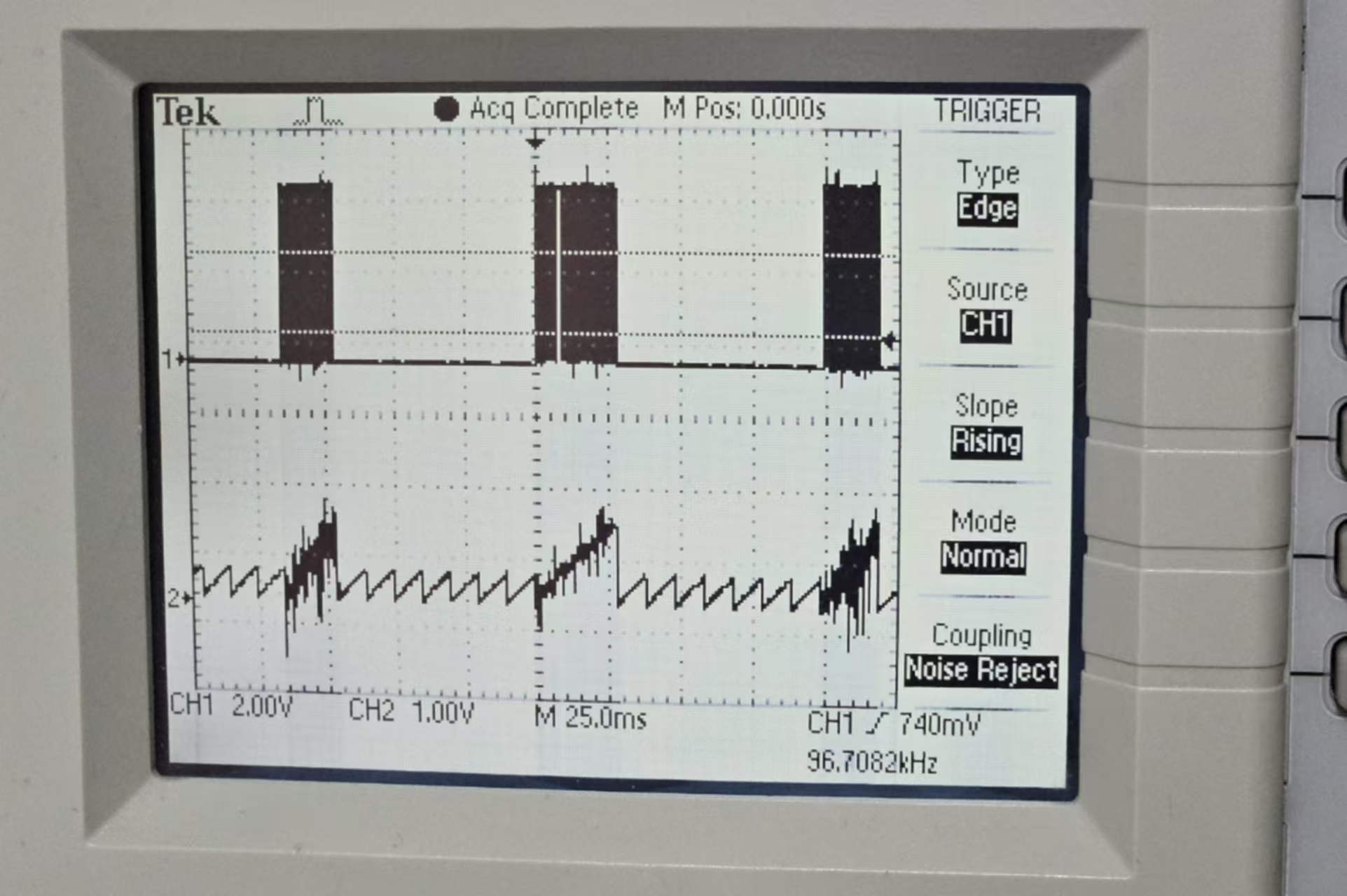

i use tps40090 and ucc27223 make a 4 phase buck controller,because i need constant current control,so i bypass the internal err opamp,use external err opamp and connect the output to tps40090 comp iput directly,and use instrument opamp to acquire each phase inducor current。when powered up ,the pwm signal seems strange,it works as the picture,all 4 phase pwm signal will shutdown few millionsecons and then back to normal。
then i give voltage directly to the comp input, when voltage beyond 1.4v,pwm signal begin(just as i read from the forum),then the duty cycle quickly rise and get into the discountious mode,when voltage beyond 2v,pwm rise to max and didn't shutdown again。
can you give me some guides to figure it out,thanks

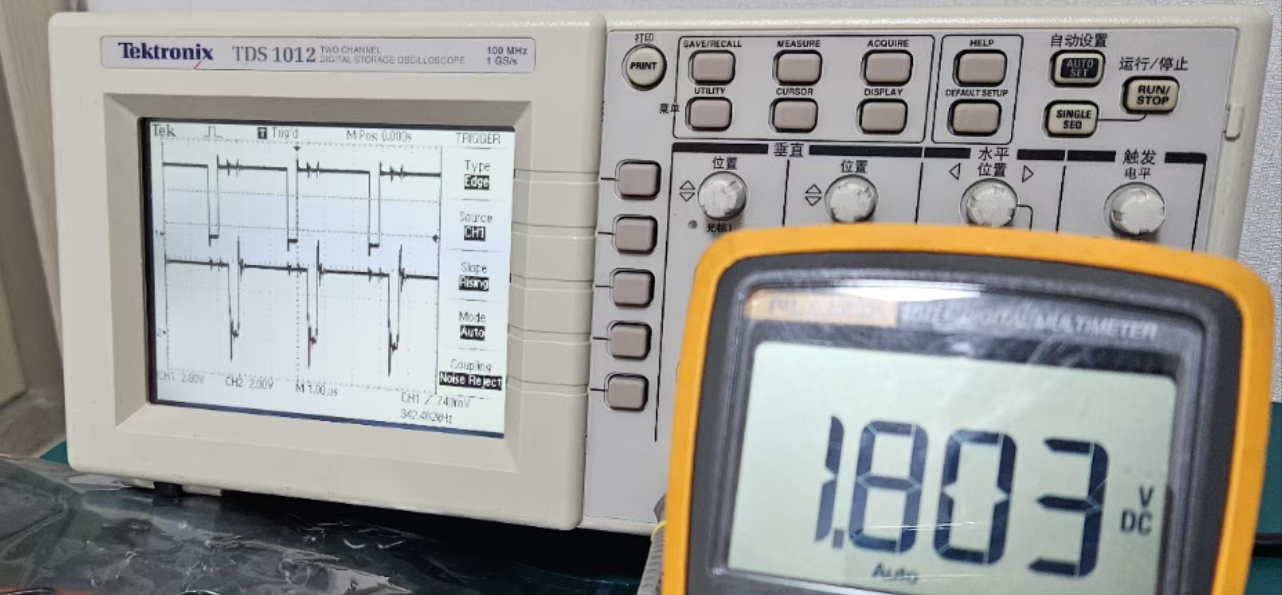

    Yes,FB & DROOP connect to REF directily。COMP forced by external voltage generated by Opamp circuit with limit between 0.5 V~ 2.9 V。

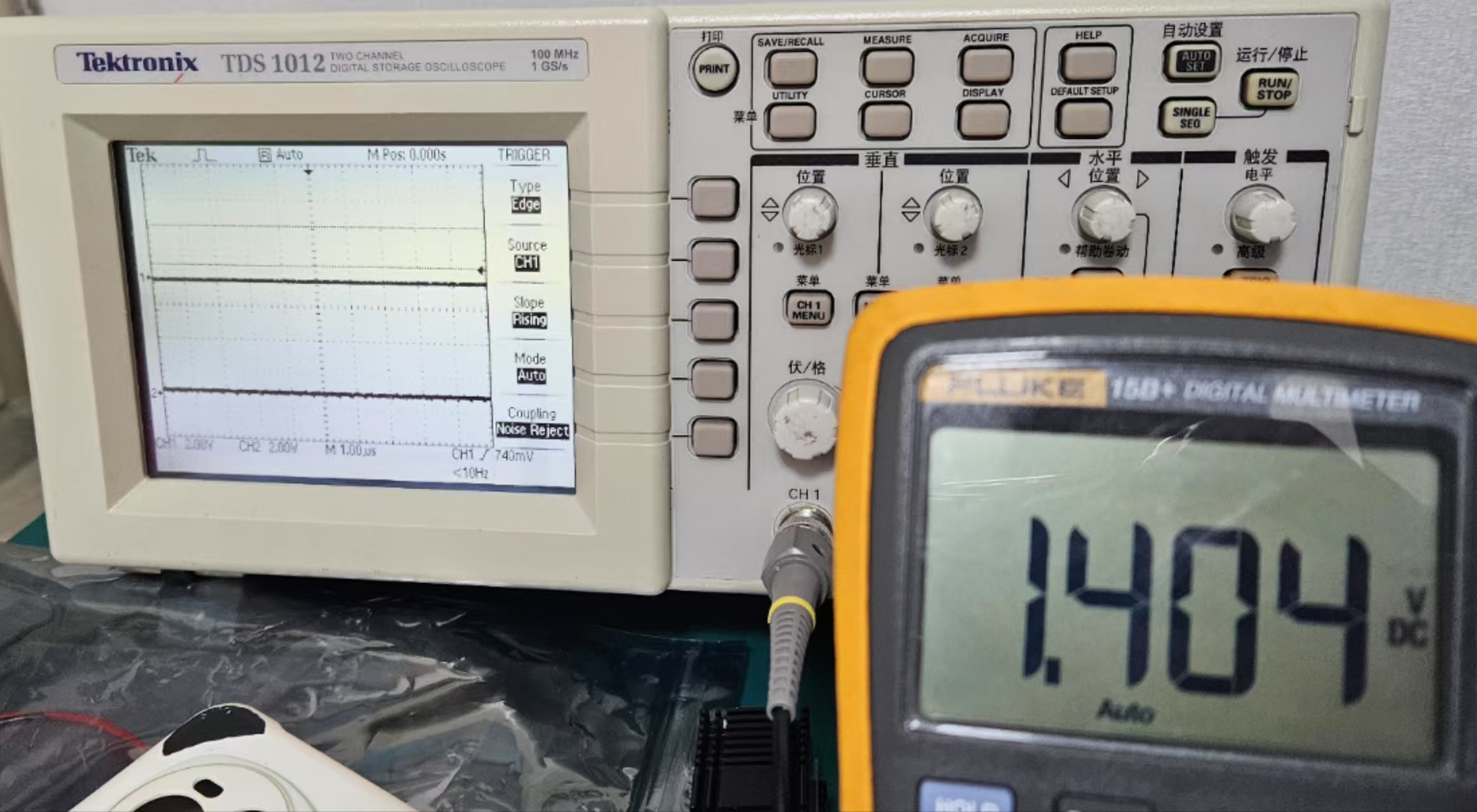

    When didn't EN ucc27223 ,FB >1.4V PWM signal begin to generate, oscilloscope's channel 1 = PWM1 ,channel 2 = PWM2,The multimeter shows the voltage at FB point

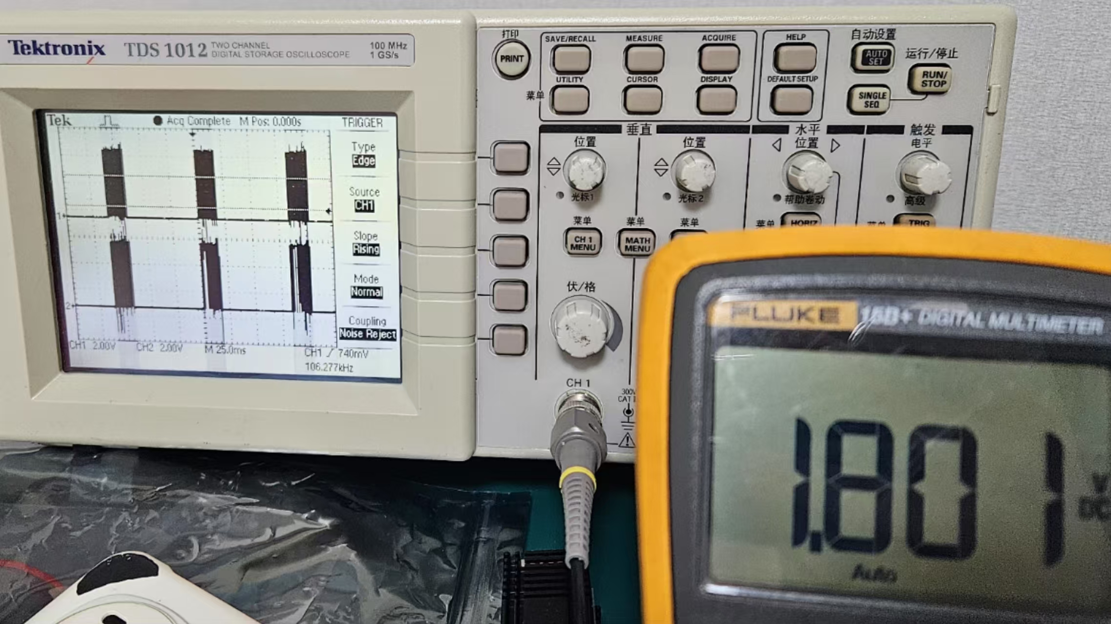

    when FB voltage is 1.8V ,PWM reached it's maximum duty cycle

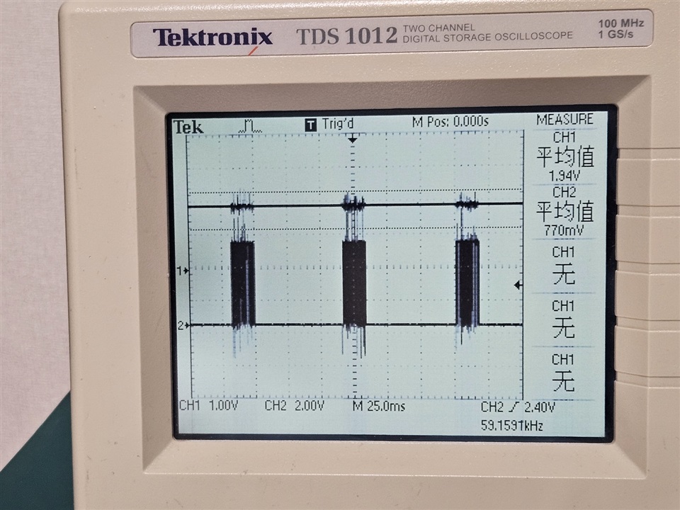

    when EN ucc27223 ,The PWM signal begins to become discontinuous
    then i change channel 2 = SS,The results show that some kind of failsafe seems to have been triggered
    I think there is something wrong with my CS1~4 circuits?

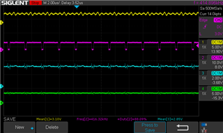

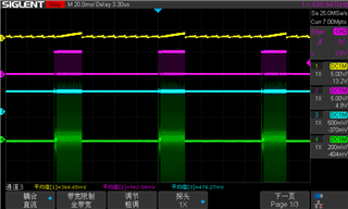

  • Hi,here is some wave
    channel 1:Vin
    channel 2:TPS40090 PWM 1
    channel 3:TPS40090 COMP
    channel 4:TPS40090 SS
    Rload=0.5 Ω ,Apply Vdcdc_in ≈3.10V ,it's work at maximum Duty ,PWM signal continued
    When increase Vdcdc_in  at some point,PWM signal began to discontinued,The voltage on the SS terminal starts to charge repeatedly, it looks like some kind of fault protection is triggered。Because I have forced the FB terminal voltage = REF, the over-voltage and under-voltage protection will not be triggered. So the only possibility is that the overcurrent protection is triggered?

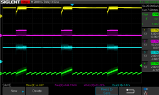

    Then i check the CSCN voltage ,It seems that some problems have been discovered
    channel 2:TPS40090 CSCN
    channel 4:High-side gate voltage of PWM4
    When shutdown Vdcdc_in【VDCDC_in is only connected to the upper-side input of each phase】 ,Only control voltage,CSCN = 0.486 V
    When Vdcdc_in=3 V,CSCN change to  1.04 V
    Then I checked my CSCN circuit. I used a voltage divider resistor to generate a reference voltage of 1.5 V, as shown in the figure below, but it seems that the CSCN pin of TPS40090 has a large sink current, causing the actual voltage to not reach 1.5 V and has fluctuations.
    So CSCN needs to be connected to a low internal resistance voltage source? Is it possible to adjust the voltage dividing resistor to the hundred ohm level?
    I don't know if this is the reason for PWM discontinuity.

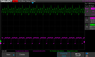

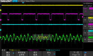

  • Hi,Now i confirmed it's a over current protection.
    Channel 1:TPS40090 SS
    Channel 2:TPS40090 PWM1
    Channel 3:TPS40090 ILIM ,Set to about 473 mV
    Channel 4:INA849 CS1,【I connect the CSCN directly to AGND finally】
    When PWM continued ,CS1 wave strange (Not saw wave as simulate)

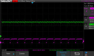

    Then I increased Vdcdc_in until PWM discontinued,
    Noticed some spike on CS1 causes PWM1 shutdown prematurely。
    Zoom out:
    I checked PCB layout,there should be some problems with my AGND and PGND layout,which lead to poor cs wave.
    I think I need to redesign this project.
