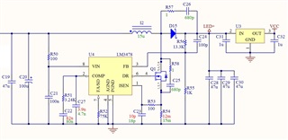

I made a circuit with the LM3478 in boost configuration, Vin 4-10.5V, Vo required 18V @ 600-900mA. The current is not changing, I mentioned 600-900mA as the right level will be decided later.
I followed the WB design which looks like in the schematics below except for the parts in red which are close to the needed values:
I added the MOSFET and Diode subbers as a habit, the circuit was tested with and without them.
The long introduction in short.... not working.... at the output I get the Vin less the drop on the diode.
As the circuit is powered by a DC-DC based on the LM5013, at some point I started to suspect a possible startup current limitation problem.
Yesterday I played with the Excel Tool and found that the Iset resistor can be increased, lowering the peak current. Is this true?
I will appreciate if you can assist with a solution to lower the startup current to minimum.

    If you see the device is triggering overcurrent protection during startup and the output voltage cannot be reached, you can indeed reduce the sense resistor R54 to increase the current limit. Please also check if the compensation is suitable for the design parameters and the system runs stable.
    Unfortunately, the LM3478 device has a fixed startup time of 4ms, which cannot be increased, so some inrush currents may not be avoidable.

    One thing I need to mention is that there are enormous differences between the WB design and the quickstart calculation tool, totally unexplainable.
    For example, the WB specified Rsen 12mohm while the excel calculates 39.5mohm.
    Increasing the resistor value decreases the inductor peak current.
    And the last thing, the compensation network returns serious changes in the resistor and capacitors. Which is more reliable, the WB or the Excel?

    The difference between WB and Excel might come from the equations used to calculate the "actual inductor peak current limit"
    There might be something wrong with Excel formula here, so I will check with a designer if all parameters are implemented correctly. (For example, if the internal slope compensation is not considered, the sense resistor recommendation will be too large)

    I tried to replace the 12mohm (WB) sense resistor to 50mohm (Excel).
    Then I noticed that in many circuits I see the feedback resistors in range of >100K. The WB recommended 13.3K/1K for 18V output.
    I replaced them with 133K/10K and it started to work. I didn't made complete testing yet, but the voltage looks stable. I am still with the 50mohm.

    So you see a difference just by changing the feedback resistor sum?
    This would mean the issue is not only related to the current sensing circuit.
    It is definitely possible that the stability of system can suffer by the wrong choice of feedback resistor values. Here is an app note that give more explanations on this:
    https://www.ti.com/lit/an/slyt469/slyt469.pdf
    As the system runs stable with the new values, I would continue testing with this state.
