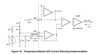

Dear TI team,
Would it be possible to provide some information for the leakage current on pins TSET and TSENSE ?
Do you have any characterization data how much it is the deviation of the cut of threshold (within temperature) typically 17.5% from Iset ?
What is the purpose of R6? I am looking to optimize the performance of the circuitry in 60-100deg.C range, so R6 introduce only additional spread of the thresholds, I can`t see any benefit of it ?
Momchil
