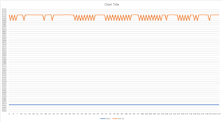

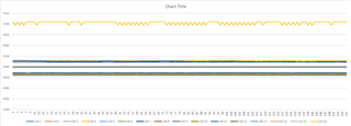

I am using BQ76952 in 16S configurations on the LFP battery Pack. Facing fluctuations on 16th number cell voltage measurement around 15mV on steady state and other cell voltage around 1mV which is normal. Below are the Firmware config and Images details.
-> All Cell image and check 16th yellow cell.
-> Below is 1st cell vs 16th cell
Can you please let me know what can be the cause of this.

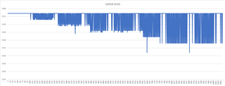

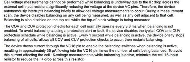

  • I have checked and found that the fluctuations value on the 16th cell depends upon how many cells are balancing other the 16th, like
    When only 16th cell is balancing -> 1mV
    When 16th and 14th cell are balancing-> 4mV
    When 16th, 14th and 12th cell are balancing-> 7mV
    When 16th, 14th,12th and 10th cell are balancing-> 11mV
    When 16th, 14th,12th,10th and 8th cell are balancing-> 15mV
    When 16th, 14th,12th,10th, 8th and 6th cell are balancing-> 19mV
    Below is the graph of the 16th cell voltage measurement with the number of cell balancing.
    Please check this identification and let me know the reason for that.

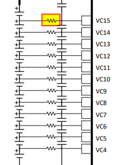

  • I found out the cause of fluctuation on top cell as written in BQ76952 cell balancing document, as below
    But here is written to avoid this you need to balance one cell at a time, but in my requirement, I can't do this. As written in the data sheet also that at the time of cell balancing there will be no cell measurement, then why this is happening?
    Need help on this to avoid fluctuations.
  • Hello Raja,
    The IR drop can be reduced by limiting the maximum number of cells allowed to balance simultaneously. This doesn’t necessarily mean it has to be a maximum of 1 cell at a time.
    Also, changing the input resistors can help as well. Have you tried changing those values to see if there was a difference?
    The paragraphs below mentioned in Section 10.1 Cell Balancing Operation of the BQ76952 Technical Reference Manual might help answer your question.
    Alexis

  • Hello Raja,
    The device disables balancing on any cell being measured as well as any cell adjacent to that cell, however, other cells not adjacent to the one being measured can still be balanced as this occurs.
    While other cells not adjacent to the one measured, are being balanced, the device draws current through the VC16 pin to enable the balancing switches.

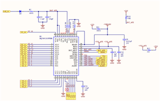

    I was referring to these input resistors to the cells as shown below. I believe that would be R13 (100 ohms) from what you shared. If you could change that resistance to something smaller, that should also help with reducing the IR drop.
    From looking at what you have shared with your schematic, if the FUSE pin is not used, you can leave it floating or connected to VSS. If the LD pin is not being used, we recommend connecting it through a series resistor to PACK+ connector or connected to VSS as well. Further information on what to do with unused pins can be found in Table 16-3. Terminating Unused Pins in the datasheet.
    Alexis

    Thanks for the reply, I have tried reducing the V16 100 ohm resistance to 56 ohm, and fluctuation has also reduced to 11 milli volt from 21 milli volt. But I need a proper solution to this, it fluctuation is also not acceptable to our clients. Can you please help me with this, Is there any way to stop balancing at the time of automatic cell sensing?
  • Hello Raja,
    Unfortunately, there isn’t quite a way to stop all balancing at the time of automatic cell sensing.
    Even if you had a maximum of only 1 cell allowed to balance, balancing would not stop unless the cell that was being balanced was currently being measured.
    I would recommend dropping the resistance to 20 ohms and see how the fluctuations look.

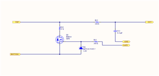

    Or taking 20 ohms, actually, we are using external cell balancing with 47-ohm resistance and MOSFET, we moved to this because inside cell balancing creates heat in the IC. if I change the resistance to 20 ohms of V16 cell then again more balancing current will flow inside the IC then again it will create heat and increase error in cell measurement.
    Please let me know any other way.
  • Hello Raja,
    Why is it taking current form V16 pin, it can be taken from the BAT pin also, from where all other systems are working inside the IC.
    That was how our part was designed. Figure 1-3. BAT and CP1 Pin Equivalent Diagram and Figure 1-20. Pin Equivalent Diagram for the Top Cell Input Pin in the Pin Equivalent Diagram partially show the internal pin connections.
    As for switching the resistances to 20 ohms, you wouldn’t have to do that with all the input resistors. Just R13 should be helpful since the IR drop affects only the top cell measurement.
