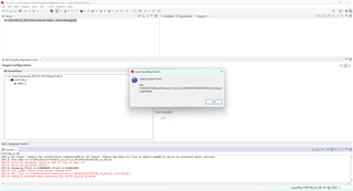

Hi
I encountered the following error while using the XDS110 programmer to burn UCD3138:
May I ask what caused it?

Hi Jonathan Wong,
Thank you for sending the JTAG configuration document. I have successfully burned the simulation program. I found that during the configuration process, it is necessary to use the USB-TO-GPIO2 tool to view and modify the JTAG pin configuration of the IO multiplexing register. At the same time, I also found in the UCD31xx technical reference manual that the default value of IOMUX does not configure the TDO pin as the JTAG pin. So, I would like to confirm whether the new chips manufactured by the factory need to use the USB-TO-GPIO2 tool to view and modify the JTAG pin configuration of the IO multiplexing register?

No, JTAG must be enabled by PMBus. A fresh UCD3138A from the TI factory will have PMBus enabled but not JTAG. Typically, JTAG is only used for debugging purposes to step through the code. PMBus is the preferred communication method for both development and production.
