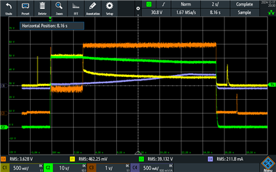

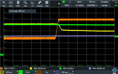

  • Hello Hemanth,
    1) (a) Please find the observed maximum duty probed image in below link (As per captured maximum duty is 72%)
    /cfs-file/__key/communityserver-discussions-components-files/196/Duty-calculation.pdf
    (b) Please find the Compensation output-CH1 (Yellow - input to the opto coupler), Vout-CH2 (green), Vcomp-CH3 (Orange) and Iout-CH4 (Purple)
                         Image 1 overall capture                Image 2 During load current increase output voltage getting dip showed in 100ms

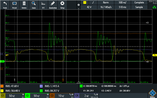

    (c) Below mentioned image captured in output switch node response while loading the output in 28V input
    CH1 (Yellow) - SEC-Series FET drain, CH2 (Green) - SEC-shunt FET drain, CH3 (Orange) - Vout, CH4 (Purple) - Input current
                    Image 3 Vout at 0.5A load
    2) During output load increase output voltage also getting decreases shown in image 1load varied from 166mA to 500mA.

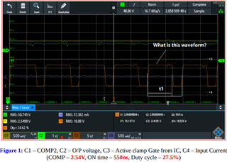

    What is the below waveform? Is the duty cycle actually t1/T?
  • Hi Hong,
    It was mentioned below the waveform probed image, Since the active clamp MOSFET as operating inverting operation OFF time the gate will be MOSFET ON time.
    Prasanna
    To help understand your waveforms, please provide the waveforms at LM5034 pins.
  • Hello hong,
    Shared waveform is probed in LM5034 IC's Pin no. 12 (AC2) since it is an active clamp gate drive you have to consider the OFF time duty to drive the P-CH gate.
    The active clamp MOSFET (AC2) gate will be inverse to the Main MOSFET (OUT2) gate.
    Hope this clears your doubt...
    Prasanna S
    The specified duty cycle means OUT pin duty cycle. Please show OUT pin duty cycle or indicate which waveform is for OUT pin waveform to show duty cycle you measured. The external circuit like inverse can affect the duty cycle so not able to judge the LM5034.
