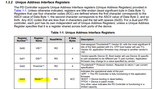

    Is the mode register the 0x5D register in the Technical Reference Manual?
    Is it correct to understand that it refers to the FPGA-PD patch?
    No, it should be register 0x03 in the TRM.
    This is the operational mode of the PD controller.

    Sounds good. When it works and when it fails, can you report the mode register?
