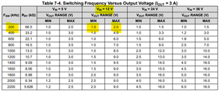

Hi team,
Could you help to explain the limitations of VOUT range and how to calculate it using the example of VIN= 12V and FSW= 200kHz? Thanks!
Sam Ting
  • Hello
    The limitation on the low end of Vout is the reference voltage of 1V.
    The limitation on the high end of Vout is the combination of frequency and the fixed 2.2uH inductor.
    Since the inductor value is fixed in a module, you will have limits on the combinations of frequency and input/output
    voltages that can be used and still maintain a reasonable inductor current ripple.
