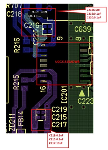

  • Hi Hiroki-san,
    I asked the customer, but unfortunately they said they could not provide a detailed circuit diagram or waveforms.
    However, I was able to obtain an excerpt of the layout.
    Looking at this diagram, it appears that there is decoupling for each of the two VCCI PINs.
    Normally, I think the two VCCIs are connected as short as possible and one decoupling is connected.
    It would be helpful to our customer if you could also let us know whether this is a problem or not.
    20240110参考回路図・検査手順rev3.xlsx
    Hiroshi
  • Hi Hiroshi-san,
    Understood, thank you for letting me know!
    From the layout snippet, nothing seems to stick out as unusual.
    Out of curiosity, is this occurring on multiple gate drivers or boards?
    Hiroki
