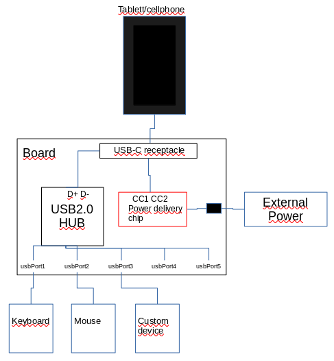

Did buy a evaluation module TPS2583XAQ1EVM to build a PD + Data board if all works good I'll make my own board.
Want make a board that could provide power to tablet or cell phone and at the same time the tablet or phone see a device connected, like keyboard or mouse.
Think it's could be possible using TPS25830A chip.
Couldn't reach my target using evaluation board. I did connect a mouse using female to female adapter connected on J4 and providing power with VBUS.
I did let open CTL1 and CTL2 to reach Type-C (3 A) + CDP Mode.
About J5 & J6, I'm little confusing with Rd and Ra, but tested different combinations.
Thanks!

  • Hi Alex,
    I'll explain me using schematic:
    Image it's better than thousand words!
    USB hub it's really done and devices too.
    So I'm looking for device that could manage CC lines to charge tablet while using the devices that plugged in the hub.

  • Hi Daniel,
    Thanks for the diagram explaining the application. Let me re-assign this thread to our team member handling the appropriate devices. They will be able to help you.
    Happy New Year!
    Alex

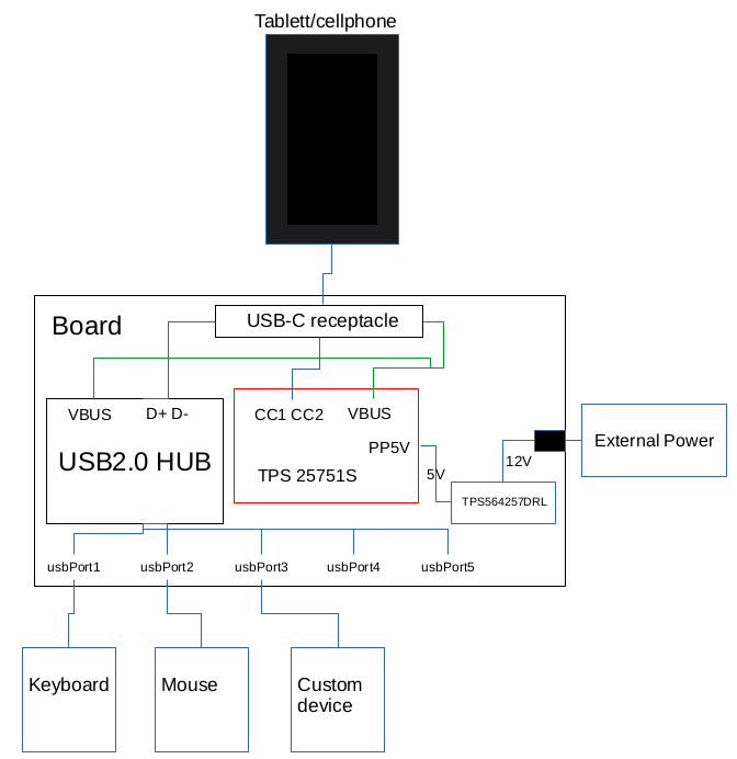

  • Hi Alex,
    No need PD feature over usb ports because just for connect conventional usb 2.0 devices.
    Our design no use an internal battery, then charger battery feature of TPS25751 have no sense in this case, if I don't wrong, so select TPS25751S version could be right because no integrate the gates to charge a battery.
    Updating the schematic:
    Updated
    Thanks!
  • About down step voltage regulator with TPS564257DRL it's done and working.
  • Hi Daniel,
    If you only need to source 5-V, then the TPS25751S should work in your application. Does the PD port need to be able to sink? Why is a PD port needed here?
    Thanks and Regards,
    Chris
  • Hi Chris,
    The board sink power from tablet/cellphone? No, because can not provide power as long time of use. If I don't understood bad your question.
    To provide power to tablet/cellphone and operate long time all the schematic. The power comes from external source, main source, and loads peripherals connected and charge battery of tablet/cellphone. So I need chip that mange CC lines to tell to tablet/cellphone "I could provide the power, use me!" and at same time still work with the peripherals connected to USB hub.

  • Hi Daniel,
    I would take a deeper look at your type-C requirements if you do not need multiple power or data roles, and don't need to supply >15-W of power from the port.
    Type-C PD is primarily used for one of the following:
    1. Multiple power roles (sourcing and sinking)
    2. Multiple Data roles (DFP and UFP)
    3. Alternate modes
    4. >15-W source/sinking
    5. needing a combination of Power Source with Data UFP,  or Power Sink with Data DFP
    If you do not need any of these, you may want to look into getting a type-c only, non-pd controller. I primarily support USB-C PD controllers (devices like the TPS25751) so can only really help there, but if you do not need any of the requirements above, the IC might be overkill.
    To answer your questions, the TPS25751 can manage the power connection to a peripheral and would manage the port connection only on the type-c port. It can manage the CC lines and advertise a source port. If you look deeper into the Type-C spec, you may notice that for "sources", Pullup resistors will be advertised on the port. The TPS25751 will do this, but a PD controller is not required to expose pullup resistors.
    The main reason you may need a PD controller in this case is for option 5, where the tablet/cellphone wants to sink power and be a Data DFP. For USB-C PD, a device can enter a contract only as either a Power Source/Data DFP, or a Power Sink/Data UFP. After connection, it can make the desired power or data role swap to end up in the desired configuration, an the TPS25751 can support initiating and processing these swaps.
    The main difference between the S and D versions is internal vs. external high voltage power path. If you only need 5-V Source, the S version should be fine.
    Thanks and Regards,
    Chris
  • Hi Chris,
    Think that my situation is describes by point 5 and haven't a battery to charge in the board that need a high voltage path, then TPS25751S be the solution.
    If you are agree too I'll close this issue and make PCB board to testing.
    Thanks!!
