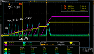

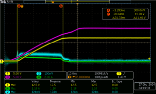

When I test with a output capacitance of 2000 uF, I measure with oscilloscope a Slew Rate close to  0,5V/ms  :  Ch1 (yellow)= Vout , CH2= IMON, CH3= gate & CH4=Iin

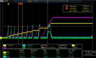

When I test with a output capacitance of 6800 uF, I don't understand its operating, it retries 8 times to charge the output capacitance  : Ch1 = Vout , CH2= IMON, CH3= gate & CH4=Iin
During the charge, the vin voltage is above UVLO, 10,87V.
I was thinking to see a charge in one time only with a SR close  to 0,5V/ms thanks the Ilimit is 18A, can you explain me what i didn't understand .

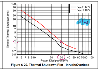

    It looks like the device is performing thermal shutdown and then auto-retry during the startup test with higher capacitor. If you check the power dissipation (annotated waveform attached), the device performs the TSD to keep the SOA of FET.
    Can you also try with lower slew rate? But your application require 0.5V/ms startup slew rate. We have a calculator which can tell if the TSD will happen during startup or glitch free startup is possible.

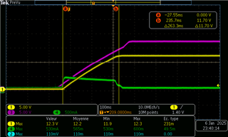

    I used the TPS25983 design calculator tool, and the calculated value of capacitor at dVdT pin at is 76nF (SR=0,06V/ms).
    So I updated C14 = 68nF and with jumper J12 in 1-2 & 3-4, CdVdT is 78nF =>  now, the large output capacitor is charged one time with a inrush current <500mA. (Ch1 = Vout , CH3= gate & CH4=Iin)
    The behavior is good!
