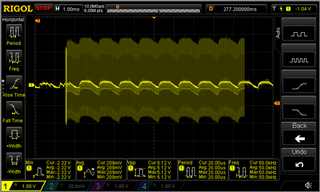

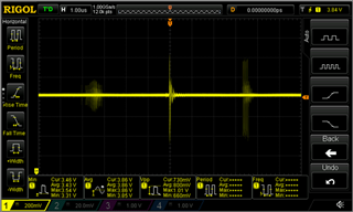

We are dealing with an issue where the BQ79616 chip is locking up. In this state it is drawing a large amount of current ~60 mA and will not respond to a HW_Reset COMM tone. Below are some measurements we have taken and tests we have tried to recover the board. From what we can tell, CVDD has a high current draw on it and this is preventing communications, but we cannot figure out what is causing the current draw.

Scope Traces while in lock up state
HW RESET COMM Tone to chip
LDOIN while in lock up state

  • Andrew,
    1. With the information we have now we can't say for certain what is causing CVDD to have a high current draw. It could be that something on the COM pins is getting damaged and a transistor is put into the wrong state or slightly damaged which is causing the current consumption.
    2. LDOIN, CVDD, DVDD, AVDD and COM pins especially.
    3. Yes I would like it at the pin side to the IC GND.
         Quentin
