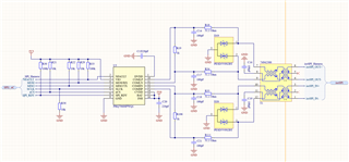

I would like to implement SPI communication via a WE transformer with integrated common mode choke. Here is an example circuit diagram:
Is there anything to say against it?

Hi Rene,
The choice of transformer primarily affects you EMI results. The primary characteristics that are important for choosing a transformer for our product are:
-The common mode rejection ratio
-The insertion loss,
-the primary inductance.
-Return loss
You can compare the datasheet transformers with the WE transformer to determine any EMI benefits
