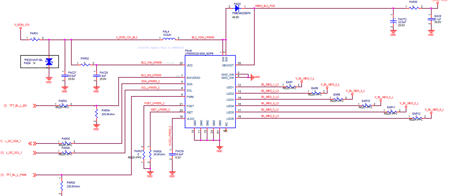

We found some LP8556 VLDO short to GND issue, Does this IC has test mode that we may configure incorrect for this IC in our device to cause damaged?
Thanks!
Jeff
Thanks!
Jeff
Hi Jeff,
Could you please send me your schematic for double check?
BR
Patrick

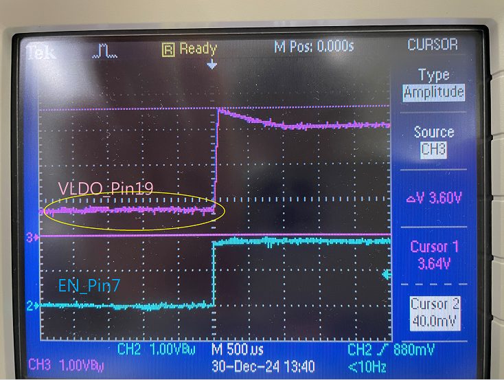

Hi Patrick,
Here are some questions about LP8556 VLDO (pin19) measured waveform, please help to check:
Thanks!
Jeff

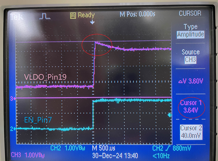

Hi Patrick,
Another question is LDO drop down to around 0.8~0.9V before enable pin drive high, will this voltage impact your internal circuit?
Thanks!
Jeff
Hi Jeff,
This voltage will not impact the IC. If you wait for a little longer, the voltage will finally drop to 0.
BR
Patrick

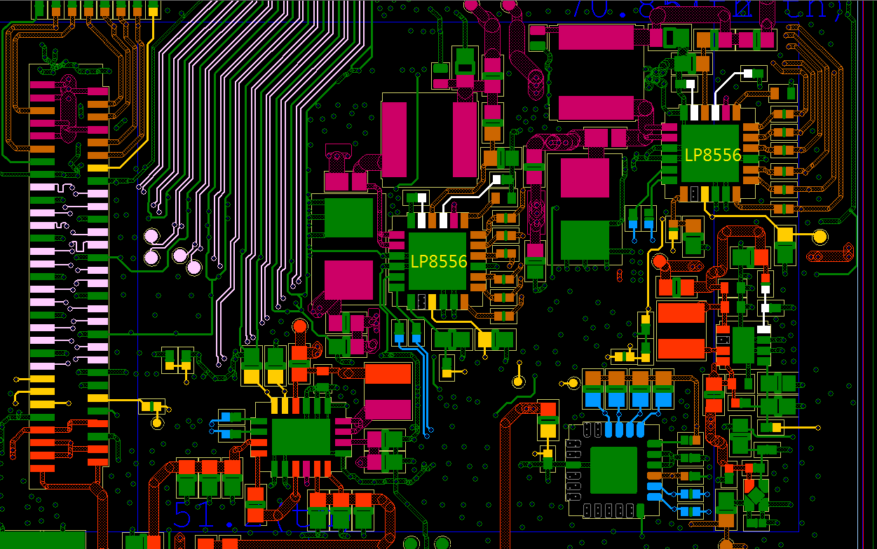

Hi Jeff,
Does customer mean they add a continuous 9V on the VLDO to damage it? May I also have a look at their layout of the VLDO part?
BR
Patrick
Hi Partick,
Yes, so they suspect there have some test mode in LP8556 may passthough high voltage to LDO and caused damaged. Is it possible?
I will asking for the layout file to you later. thanks!
Jeff
