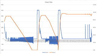

    We have been looking into the data for Battery #1 which is described as the fault pack, however the current and SOC measurement can be seen below:
    With current being blue and the SOC being in orange, the only time it seems that the SOC drops when not intended is the last section of relax, where there is a roughly 2% drop from 97% to 95%. Can you please confirm where the issue is being seen in this situation or if something is being missed?
    Anthony

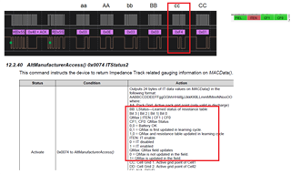

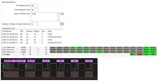

  • Anthony, I've added gauging status to the logging. I'm confused by the definition of ITStatus2 in the TRM. When I run Studio and monitor i2c, it looks like the LStatus is in the 5th byte of data (address 0x44) which I would think is byte 'cc'. But the TRM says it's byte 'BB'. Is that a TRM typo?
    Edit: I checked another battery and the first 6 bytes of 0x74 are 0x03, 0x0E, 0x00, 0x00, 0x36, 0x04. So I don't know where Studio is getting the LStatus bits!
  • Hi Jim,
    What is the result of this if done with bqStudio from your end? I've set the LStatus to 0x04 and the read out and breakdown can be found below:
    Based on this, the TRM layout of the register seems to be correct. Just to confirm, is there any issues in what is being seen from GaugingStatus()?

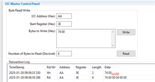

  • Anthony,
    Gauging status is okay - my reads get the same data as Studio. But LStatus does not work like yours. Studio shows the correct register value, but the Advanced comm read is wrong. The i2c trace looks the same for both reads!
  • Hi Jim,

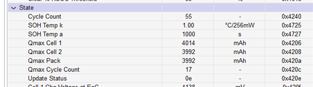

    I see what you mean, the advanced comm is returning the 0x0E (which is 14 in hexadecimal), which is the value being seen from the L Status register, however the bitwise representation of the register does not seem to reflect that.
    What is the value shown in the Update Status Register found in Data Memory -> Gas Gauging -> State?

  • I checked 10 batteries - all report 0E and RESET in Studio does not change that value. All show the same ITEN bit in the register view.
    We haven't done anything intentional to update Qmax. Can you say more about that - how it would push the register to 0x0E?
    And I assume you are still puzzled that 0x0E shows as just ITEN=1 in register view, correct?
  • Hi Jim,
    The gauge will push the LStatus to 0x0E if there is another Qmax update taken place after the learning cycle has been completed, which if this is the value of the LStatus when the golden image .srec is taken from the gauge.

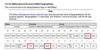

    Can you confirm that the incorrect presentation of LStatus bits is just a Studio bug? It looks like they convert the 4 bits to decimal and then interpret that as a hex value for the bit display. I turned gauging on and off, which toggles the 14 to 10 and back, and the ITEN bit goes red to green and back which is just a funny coincidence that 1110/1010 = 14/10 = 10100/10000 when incorrectly interpreted!
    Anyway, I will add those 4 bits to my logging and get that into our lab testing as soon as I can.

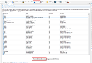

  • Anthony, Do I program the ChemID just using Advance Comm?
  • Hi Jim,
    This has to be done through the Chemistry tab in bqStudio. Once the chemID is found in the list, press Program Selected Chemistry:
    Anthony
