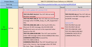

 My customer use TPS65994BH at USB4 applicaiton (with Asmedia solution) and is processing PD certification now. Customer response they need PD version as R3.1 v1.8 to get U4 logo but our FW support R3.0 v2.0 currently.
1. We use GUI  v6.4.32 currently. Does customer need to upgrade their FW to v6.4.35 fo meet the reguirement? Or is it necessary for upgrating PD version for U4 certification?
2. For those issues below, Can we fix them through modifing VIF?
