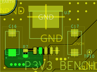

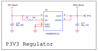

Here's the schematic implementation and routing of this regulator on the :
The implementation seems to be correct with regard to the datasheet recommendations.

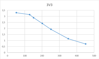

    I have just taken the following measurements :
    base load in the circuit (mA) 51
    Load Apply (mA) Total Load (mA) 3V3 5V power (W) Dissip Power (W)
    0 51 3,305 4,993 0,17 0,09
    77 128 3,149 4,991 0,40 0,24
    100 151 2,889 4,991 0,44 0,32
    150 201 2,415 4,99 0,49 0,52
    200 251 1,931 4,989 0,48 0,77
    300 351 1,15 4,987 0,40 1,35
    400 451 0,715 4,986 0,32 1,93
    The oscillograms associated with the measurements are attached.Oscillogram.zip
    For information the 5V regulator is the LM2677S-5.0 with 260 kHz switching frequency which we can see clearly on the graphs
    Let me know if you see a potential source of the problem

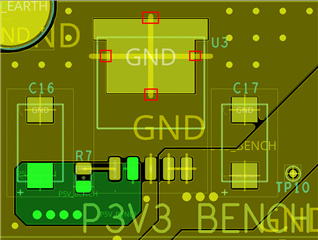

    This looks like a thermal issue after all. I noticed in the screenshot of the PCB layout that the thermal pad is only connected to the ground pour at the 4 points that I highlighted below and is otherwise isolated. Am I correct? If so, the on-board heatsinking is severely limited and the thermal performance will be much less than the datasheet metrics suggest.
    Nick
  • Hi Nick,
    Thank you for your comment. Indeed, the thermal pad is only connected to the ground pour at the 4 points that I highlighted. However, there are more than 20 board with this design that are fully functional. Only 2 boards have had this failure, and we think it's possible that we've come across a batch of faulty components. What do you think?

    In any case and for future projects, it is recommended that no thermal brakes be applied to thermal pads? Does this cause any problems for component assembly and/or removal?
    Yes, the recommended layout is a continuous connection for the thermal pad with thermal vias under or near the thermal pad. I do see thermal vias near the device in the layout, but with the limited connections the heat cannot easily leave the thermal pad. There won't be issues with assembly, but removing the device is certainly more difficult when the board-level heatsinking is improved. With that said, it's usually not much of an issue if you have access to a heat gun to remove the devices. Some of our EVMs are highly thermally optimized and it can be difficult to get the device off the board, but in many applications there isn't enough board space available to achieve such a high level of board-level heatsinking, so I wouldn't consider it an issue.

    Yes. The junction temperature will rise a lot more than expected with the reduced board-level heatsinking. However, what is not clear to me is why the output voltage looks to be "sagging" when the load increases (heating the device); this is a CMOS device, and for CMOS devices the thermal shutdown is usually an abrupt turn off instead of the sagging that is seen in the data they collected. The waveforms they provided seem to show that the output isn't turning off, but the time scale is pretty small (2us/div or 800ns/div), so it's unclear whether the output is turning on and off (cycling in and out of thermal shutdown) or if the output has just sagged. If they can collect some more measurements showing the output voltage on a DC coupling and a more zoomed-out time scale (e.g. 10ms/div) at an elevated load current that sagging has been observed, that would help assess the issue.
