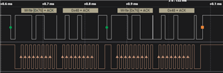

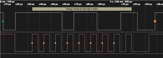

    The application for this is to supply power from the voltage output through a trace to heat it up and control the short to ground via a MOSFET gate that is being PWM'd. The device I am trying to read from and having issues with the I2C is a temperature sensor to get the temperature of the surrounding area of the trace.
    Here are some waveforms I was able to capture.
    TPS55288 Disabled:
    TPS55288 Enabled:

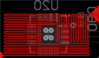

    As can be seen, once the device is enabled we are no longer able to get a proper response from the temperature sensor. Currently for the layout, the temperature sensor is directly below the trace that is being heated and powered from the TPS55288 as seen here.
    Our current theory is that the switching frequency of the supply could be possibly effecting the internals of the temperature sensor due to possible EMI and the switching frequency being within the i2c frequency of 100kHz to 400kHz. Hence, the other question I asked and you answered about changing the switching frequency, however when we did this the high side FET was broken.
