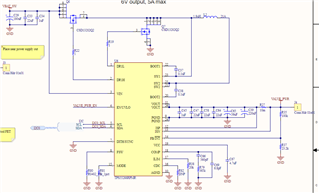

I have been attempting to change the switching frequency for the TPS55288 by changing the resistor for the switching frequency on pin FSW. Ideally, I was looking to have a 600kHz+ switching frequency however when I switched out the resistor we currently have on board (50kOhm for 400kHz) for a 21.5kOhm for a ~900kHz switching frequency the high-side FET ended up blowing.  According my schematic capture and the datasheet everything seems to be configured correctly to be able to change this resistor anywhere from the range 9.09kOhm - 100kOhm. I was wondering if there was any specific reason as to why this FET broke, and was hoping to get an answer prior to putting on a new resistor for a 600kHz switching frequency configuration as these boards limited and don't want anymore broken FETs.
I have attached the schematic here. The FET in question that broke is Q6.

    1.What is the input voltage range, output voltage, output current? CSD13202Q2 only has 12V VDS.
    2.Current compensation parameters are terrible. The loop must be unstable. Please help provide part number of output caps to calculate loop parameters/

    1. The input voltage range is 4.8V-8.4V with a output voltage of 6V with a max output of 5A. We should not have exceeded the 12V VDS from the input voltage.

  • Hi Liam,
    Do you consider TPS55289 in this power level? It is full integrated. In some transient occasion Vin might increase, so 12V MOSFET is not recommended.
    For compensation parameters, recommend R79=10k, C66=10nF, C69=100pF.
    Current compensation parameters are extremely unreasonable. Device will work in huge vibration. So both TPS55288 and MOSFET have damage risk. Please use recommended parameters for evaluation.
