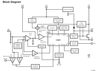

    We're always happy to help and answer as many questions as we can, if possible. Unfortunately though, we can't share how the device behaves internally, as you will understand. All I can say about it is that the SD/SS pin should be connected to ground through a capacitor. However, you can always refer to the high-level block diagram mentioned in the device datasheet.

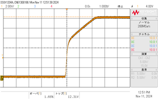

  • The current D+12V is slow rising and takes about 2mS to reach 12V. (Waveform attached)
    Accordingly, I changed the SD/SS capacitor from 4700pF to 0.01uF and tried to start up, but U3 is still broken in the same way. (It is not a protection as it generates heat due to lower resistance).
