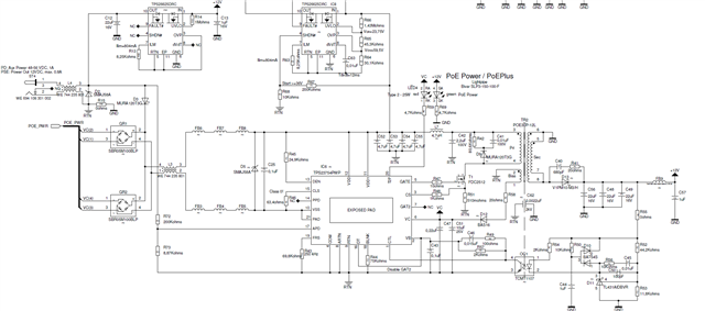

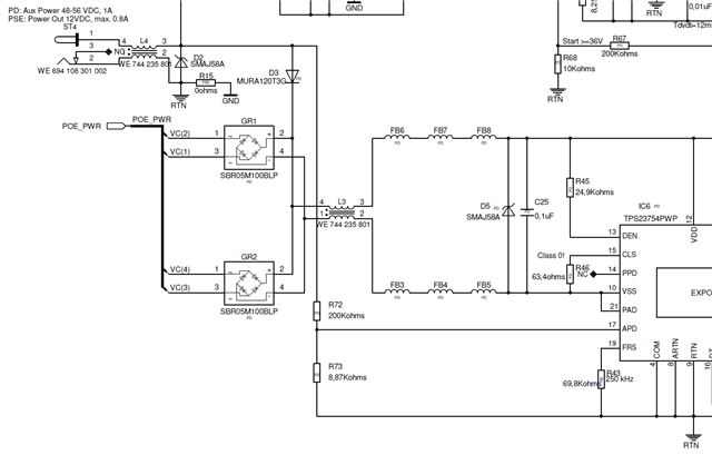

we have followed the low-cost references design with diode rectification. When we power with a plug power supply, the T2P pin does not become active, despite the APD-pin being at 2.4V, i.e. above 1.5V threshold.
Can you list some things to check that could cause this behavior?
