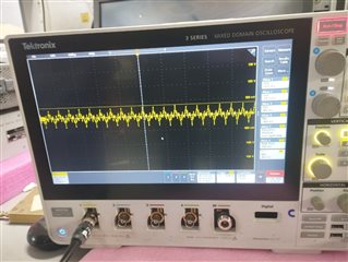

    Xray of device will be shared as soon as possible. During AGND and PGND external connection, expected output voltage is generated but 720mVp-p ripple voltage is observed. In working module, 18mVp-p is observed. Refer attached ripple voltage 720mVp-p image for your reference and solution.
    One more unit also having the same issue.
    Kindly provide root cause of this issue.
