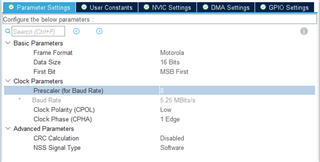

The READ value works correctly when the TPS92518 is configured with the settings below.
However, when I increase the baud rate, the READ value does not work correctly. Could you help identify the cause?

The READ value does not work correctly at prescaler values of 8 (5.25 MBits/s), 4 (10.5 MBits/s), and 2 (21.0 MBits/s). However, the WRITE function still works fine.
