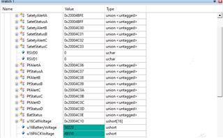

The actual voltage is 50V, the BAT voltage is sampled correctly, the PACK voltage is 1V lower than the BAT voltage, the PACK pin input voltage is also 50V, and the PACK I2C register is only 49V. What is the reason for this?
  • In addition, the PACK voltage content I read is from registers 0x36 and 0x37

  • The reference post is not consistent with my problem. It is not a problem. The reference post is that the real PACK pin voltage drops, but mine is not. My PACK voltage cannot sample the correct 50V. My charge and discharge FETs are both closed, and the input voltage to the PACK pin is the real 50V. But the PACK pin sample is 49V, which is 1V lower.
    Because it is normal operation, there is no protection or assertion.

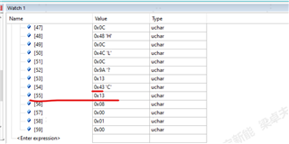

  • How are the voltage values ​​read out of registers 0x36 and 0x37 calculated? Can the original AD value of the PACK voltage be read?
  • Hello L,
    I believe the raw PACK pin voltage measurements are given with the subcommand 0xf081 READ_CAL1 as shown in Table 12-23. Subcommands Table (continued) in the BQ76952 Technical Reference Manual (TRM).
    The raw values are then corrected by first subtracting a stored offset trim value, the gain is applied, and then the PACK offset is subtracted, before the final voltage value is reported. Section 4.10 Voltage Calibration (ADC Measurements) in the TRM explains this more in detail.
