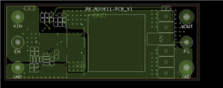

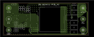

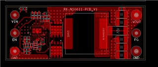

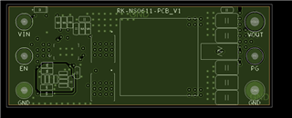

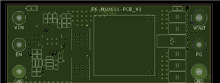

  • Hello, Tim
    After a day of trial yesterday, if I need to output 3.3V, I need to change the inductance from 2.2uh to 2.8uh (with a smaller esr) and the detection resistance to 4mΩ, which is stable at -40°, 10A. If I need to output 5V, I need to change 2.2uf to 3.3uf. Increase the output capacitance by at least 200uf, and do not use electrolytic capacitors (tantalum capacitors and solid-state capacitors are acceptable), so that it is stable at -40° and 20A. I am still adjusting these parameters, as well as the parameters of 12V output. I am curious why there is such a change at low temperature, because I can operate normally at normal temperature no matter how bad the parameters are used. Does TI have any good ideas? I did not find relevant information on the Internet.The following is my PCB layout and the quickstart of the original parameters. Sorry, we cannot contact the FAE of TI.Finally we need to get 20A for each output voltage,Thank you for your help.2402.LM5149-LM25149 Quickstart Calculator_rev3.xlsm
    best regards
          all 2oz copper
  • That quickstart file looks good...assuming the ceramic Cout is correctly derated for voltage. If you need to adjust the Vout setpoint higher, the Cout value will decrease accordingly, resulting in a higher crossover frequency. Just check it at Vout-min and Vout-max with the compensation values fixed and adjusting the Cout value as needed.

  • I have good news, after many days of trying, I found that I had neglected the derating of the input and output ceramic X5R capacitors. After I calculated the Bode plot with the correct parameters and adjusted the poles and zero by changing the inductor and output capacitor to make the Bode plot stable, such parameters were feasible. And do you think my PCB is OK? Thank you again for your reply.
    THANKS
  • Oh good.
    For the layout, go with a solid unbroken GND plane on layer 2 directly below the powr stage (see the EVM as a reference). Also, an AGND island is useful as well. Copy the EVM layout much as possible here.
    Tim
