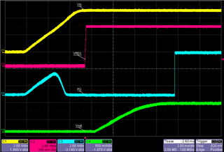

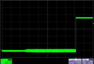

Measurements show that there is a short pulse of PG_0V85 before 0V85 is on:
This causes to enable 0V9 for a short time which is problematic.

I could reproduce this behavior with the Eval-Board TPS56C231EVM.

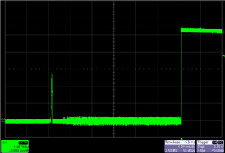

There I connected PG via 10k to Vin.
This shows a small Pulse on PG which should not be.
With the original circuit in which PG is pulled high to internal TPS56C231EVM voltage VREG5, this pulse does not occur:
My resumée:
  • Power Good output pulled to Voltage which is on before TPS56C231 enabled -> faulty short pulse on PG signal
  • Power Good output pulled to internal TPS56C231  VREG5 -> expected behavior without pulse
Is this a known issue? Or am I the only one who can observe this pulse? Is PG output undefined for some time during startup? Is it mandatory to connect PG to VREG5?

    It looks like there is some glitch that is causing PGOOD to be asserted for a short time initially. This glitch can also be caused by EN signal, Vin signal, etc. How are these signals being supplied? can you provide more waveforms for VIN, Vout, EN, PG and VREG all together to see how this glitch can be caused? TI recommends a 10kohm pullup resistor pulled up to VREG5. Can you also try decreasing the slew rate of the power-up sequence? Slowing down the startup can smooth the signal and decrease risks for glitches.

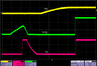

    I measured the signals which you can see below:
    Vin, EN, PG, Vout:
    Vin, VREG, PG, Vout:
    I don't see any unexpected details other than the glitch on PG. Also the ramp up time of Vout is within expectation. Do you see any anomalies?
    In addition I found out that the PG glitch does not occur if the voltage supply is turned off and on again rather quickly (within 10sec). It does only occur when the device was powered off longer than around 30sec. This can be observed on my device and also on the evaluation board.

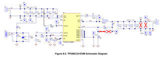

  • Hi Calan,
    See the schematic of my modified eval board (modified components listed below):
    • R3 is connected to Vin instead to VREG5
    • C7 = 200nF
    • R4 = 160kOhm
    • R5 = 20kOhm
    • Cout (C11..C16) = 200uF
    • Vin = 5V
    • Vout = 0.85V
    • FSW = 800kHz
    • Iout = 0A (open loop)
    • Tss = 21ms
    On the EVM I did not apply any load and the glitch occurred.

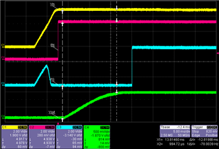

    With this modifications I can produce the PG glitch as following (same plot as in initial post):
    Can you reproduce the glitch on your side?

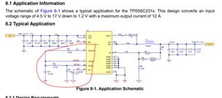

    Overall, the main potential issue I see with this is connecting PGOOD to VIN. Typically, I have not seen this in TPS56C231 schematics. Normally, the best approach is to connect it to VREG5 with 10kohm resistor. I believe this is the only reason for the glitch in PGOOD. The components and BOM for the most part look ok and do not seem to be related to this. Please attach PGOOD to VREG with 10kohm and please adjust the SS cap to 0.047uF. The Vin, Vout, and FSW conditions look normal.
    Calan
  • Hi Calan,
    Thank you for the solution of the problem. Pulling PGOOD to VREG5 solved the issue with the glitch.
