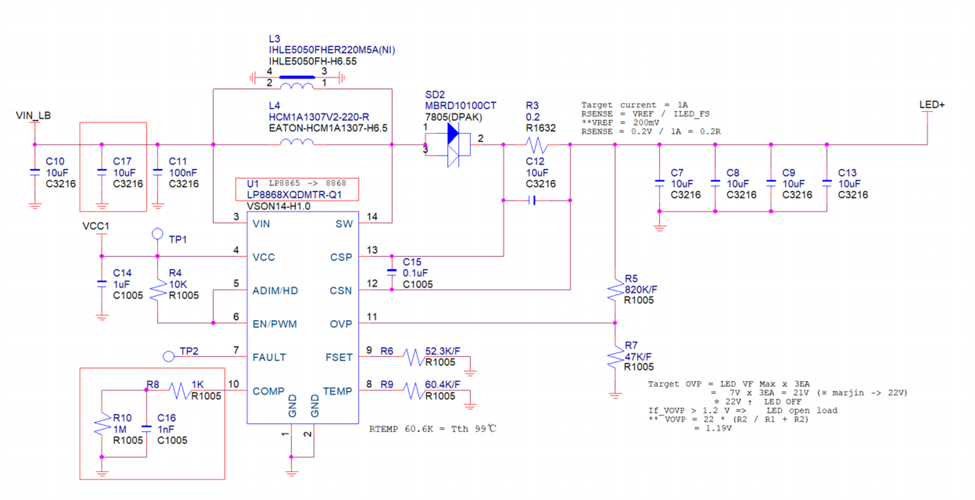

LP8868X-Q1: Please review the schematic, and some questions.
Part Number: LP8868X-Q1
Dear TI experts,
My customer made a sample module using LP8868XQDMTR-Q1.
Could you review the schematic below first?
And here is a question ;
If the VIn is normal(usually 13.5V), everything is okay but if VIN is under 10V, they found high frequency noise. So they changed the value of C16 from 1nF to 100nF. And hthe noise disappeared.
- Is it okay to set C16 100nF?
Please check this issue. Thanks.
