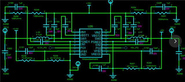

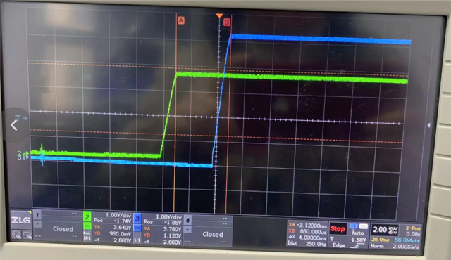

TPS54394: Vout 3.3V and 5V enable 4ms difference
Part Number: TPS54394
Same En pin R and C,but Vout 3.3V and Vout 5V have 4ms difference,what is the reason?
