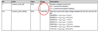

These are the register values set by me
ref_lsb_value = 52
ref_msb_value = 2
iout_limit_value = 255
vout_fs_value = 3
cdc_value = 224
mode_value = 161
2. Need a guidance on how to set output current at a specified level. For example, the output current can be 0.04A or 0.1 A or above that.

    1. Below is the breakdown of registers in binary code
    ref = 1000110100
    iout_limit = 10000010
    vout_sr = 00000001 #
    vout_fs = 00000011
    cdc = 11100000
    mode = 10101000
    2. I have selected internal feedback from VOUT_FS register, and it is at default value of 0.0564.
    3. I tried setting output current using VISP-VISN value but didn't get the result. I want to set the output current to 0.1A and maintain it throughout the process.
    What should be the register values to achieve the same.

    1. From your shared register values, the output voltage is set at 12.08V, Vref=681.756mV, feedback ratio=0.0564, Vout=Vref/ratio=12.08V.
    2. The VISP-VISN voltage is set at 1mV, which means the output current will be limited at 1mV/10mohm=0.1A. If the device is operating at PFM mode, it is difficult to realize the constant current output.
    3. From the MODE register values, the external VCC is selected, recommend to keep using internal VCC. Otherwise you will need to use one external 5V/100mA to supply VCC.
