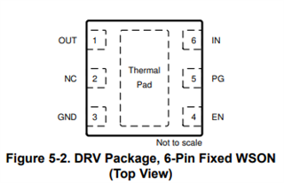

  • Hi Nick,
    The same library have been installed, but it has Adjustable mode IC and other variants (containing 4pins only) of it
    Can you particularly specify the IC (subckt) to be used for Fixed 1.8V output? We need the pin configuration as shown below . Image taken from datasheet
    Also in the variants EX:- .subckt TPS74501P_S2 1 2 3 4 --> we cannot identify the pin functions. Could you specify the pin functions for this and also differentiate these variants  - TPS74501P_S1,2,3,4, TPS74501P_F1, TPS745H01P_H2?
  • Hi Aishwarya,
    I'm not sure exactly what you mean by this. The model I sent has 5 pins.
    I did forget to go back through and change the naming convention. See the attachment below for the model with the naming convention updated to reflect the 1.8V fixed version.
    1538.tps74518p_trans.zip
    In the model I just attached, the main .subckt is TPS74518P_TRANS. The remaining .subckt are used by the main one.
    TPS74501P_S2 in the previous model is a voltage-controlled switch. The others with a similar name, e.g. TPS74501P_S4, are other switches with different on/off characteristics. The TPS74501P_F1 is something like a current-controlled current source, and TPS74501P_H2 is similar. These are used in the main .subckt, and it's not important to understand how each of them works.
