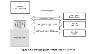

I am trying to demonstrate a single USB-C cable solution for PD (20V 5A) + DisplayPort + USB2.0. Basically a setup of Source board-Sink board system for proof of concept.
The TPS65987DDKEVM alone can only do PD, but it has an Expansion Connector I/O for external USB2.0 and DP boards.
Are there such expansion boards that include TUSB1046-DCI/TUSB1064 redrivers for DP and also allow me to pass through USB2.0 lines from Host to TPS65987DDKEVM.

  • Hi Ming,
    Your understanding is correct. The 10G-EXPANSION-EVM is no longer available as we were not able to guarantee that it could provide 10G with various setups.
     The TPS65987DDK EVM can be used to show DisplayPort PD messages on the CC lines and can be configured through the GUI Tool. See the following application note for more information.
    The TPS65988DK EVM has the TUSB546 to test DP Source. See more in the EVM user's guide
    Please let me know if you have additional questions/concerns.

    Unfortunately, we no longer support the 10G-EXPANSION-EVM. The TPS65987DDK EVM can still enter DisplayPort Alternate Mode without a "Display" and can be seen through PD messaging as outlined in Section 4 of the Application Note provided.
    One more suggestion would be to utilize the TUSB1046/1064 EVMs for a DisplayPort proof of concept as well. See TUSB1064 product page here
