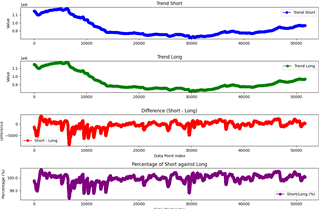

    HEre is a graph with the last test I ran for 10 days, just in case the values seem odd or you spot something that is not right
  • Hello Victor,
    You can have EOS pulse threshold count set to 10 for now (for testing purposes), you can change this to an appropriate number once you get a full complete data set from testing.
    I want to change your test procedure slightly.
    1. Same as before
    2. Same as before
    3. Set Gauge start command
    4. Wait 1 second, then apply 100 mA
    5. Wait 2 seconds, then completely turn off load
    6. Send gauge stop command
    7. Wait for interrupt from ALERT pin with G_DONE flag.
    8. Set GE pin LOW.
    Now for step 9 this is what I would recommend, you should discharge the battery 1% SOH and then let the battery relax for 5 hours and then loop back to step 1. We want to do this to gather the impedance data for each SOH step of the battery to track the impedance of the entire battery. Now this testing could take a while, so you could also do a discharge of 2% SOH.
    I fear that your procedure is taking EOS measure too many times since there is only a 15 second wait before gathering new EOS data. That is not what this mode is designed for.
