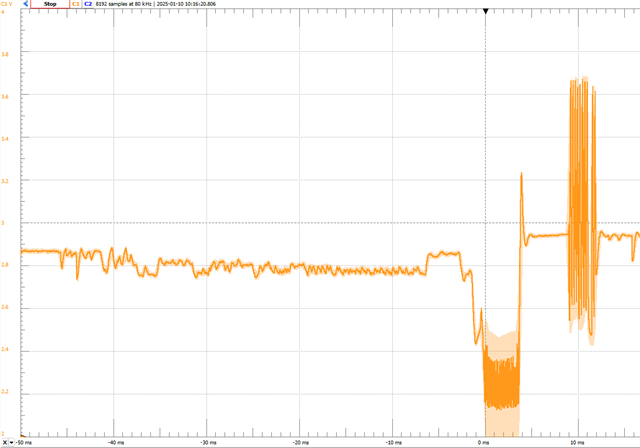

Hello E2E forum,
We are using the TPS2116 to switch between two batteries (maximum 4.08V) to power our product.
We have encountered that approximately 1% of our solutions fails due to the TPS2116 (output of the TPS2116 is crashing).
We suspect that this error is introduced by hot-plugging of batteries. The absolute maximum input voltage of the TPS2116 is 6V:

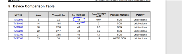

  • Hi Daniel,
    You can consider flat clamp TVS like this TVS0500 .  If hot-plug current is like 5-10A then it should clamp at lower level. You can also try playing with input cap.

    Hot-plug current is maximally measured to approx. 4A.
    By nominal specs alone (clamp voltage 9.5V, breakdown voltage 7.8V), I won't feel so confident in using this. Can you elaborate a bit on that they should "clamp at lower levels?"

    However, these are placed at the battery input rather than the TPS2116 input. I guess moving these (or TVS0500) as close as possible to TPS2116 inputs will improve protection? Or should I keep them at the source input (battery terminals)? From battery source to TPS2116 is approx. 10 cm long, 1mm wide track.
    In newer designs, I have designed for the use of a 22 uF X7R input caps with ~0.1 ohm series resistance attached in parallel to each battery at the battery connector aswell (or just tantalum).
    For this particular case, the voltage on the VOUT pin looks like this. This is observed in a quasiperiodic manner of approx. 800 ms:
    The source voltage (input 1) is stable (Li-Ion battery at 3.6V). Nothing is leaking to input 2.
    Worth noticing is that if input 1 is disconnected and applying the same voltage source to input 2, the error disappears.

  • Hi Daniel,
    1. Placing close to VIN pin will be more effective.
    2.  at 43A it will clamp at 9.2V, so for 4A current it should clamp around 5.5-6V.

    2. How do you deduce this? Will the same apply for the TVS diode TSD05DYFR?

  • Hi Daniel,
    I do some rough calculation. Calculate Rdiode as (Vclamp at ipp - VRWM)/IPP.
    VClamp at IL= Vrwm + Rdiode*IL.
  • Hi Kunal,
    Thank you for this! I see that TVS0500 has active circuitry in it. So will these rough calculations also be applicable to ordinary TVS diodes (e.g. TSD05DFYR)?
    Reason for the question is that the TVS0500 has some significant footprint to it and it will be quite hard to incorporate this in the design.
  • These calculations should be applicable to ordinary TVS also,
