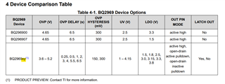

My customer want to set up 3.65V for OVP. May I know when we will release BQ2969xy and support 3.65V OVP?

Hi Bo,
BQ2969xy is a placeholder row to show the available settings that TI can program, it is not an actual orderable part.
Requesting a new spin development requires a significant business case to warrant the development.

Hi Max,
Thanks for feedback. So there is no any new spin version will coming soon, am I right?
If customer OVP voltage need 3.65V and spec need to similar with BQ2969, do you have any suggestion?
Thanks.
Hi Bo,
We don't currently have plans for a 3.65V OVP spin.
The BQ7791514 has 3.65V OVP. It's the most similar part we have to the BQ2969 that has 3.65V OVP.
