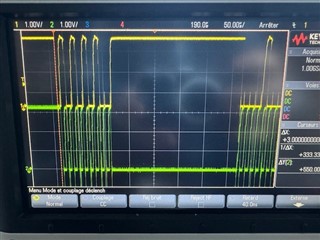

When I try to full unseal the gauge, after 20s, I get a failure message from full unseal the gauge. During programming, the full unseal code is not touched.
The timer for the unseal (0x01403672) is too long, I have a error in the software of the microcontroler since he cannot execute the commande to read the pack lot code.
 For read Pack Lot Code, the software send:
 - unseal command
- read if the unseal is complete
- if complete then send BlockDataControl with data at 0x00
                             send DataFlashClass with data at 0x38
                             send DataFlashBlock with data at 0x00
                             read the data at the address of 0x44.
On other electronic cards, I don’t have this problem.
What is the solution to fix the problem?
I can’t reprogram the gauge until I can full unseal it completely. Is there a solution bypassing the complete disassembly in order to reprogram the gauge?
