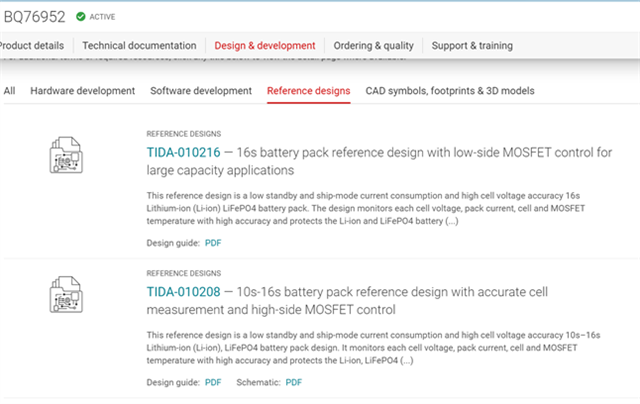

Hello Pooja,
The reference designs for BQ76952 can be found on the product page as shown in the picture below:
Please let me know if you have any issues accessing those reference designs.
Alexis
