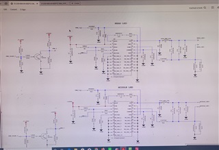

We are using TPS92513DGQT for IR LED dimming using PWM controlled from microcontroller.

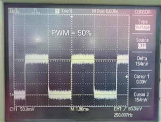

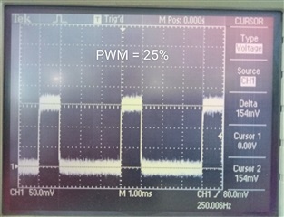

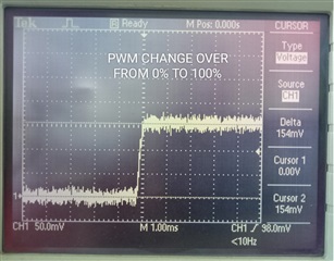

We are facing LED failures for which we SUSPECT the IC TPS92513 during OFF to ON condition give instantaneous peak current on output which opens the LED.
There are three LEDs connected in series on NEAR_LED+ AND NEAR_LED-, and two IR LED connected on MIDDLE_LED+ and MIDDLE_LED-.
The current is limited to 0.717A in both the circuits. IR LED used has normal operating current as 0.7A and the absolute current rating for the LED is 1000mA.
Please verify the circuit, if it can cause damage to the LEDs.
IR LED parameters.
Schematics of TPS92513
Waiting for your quick response.
