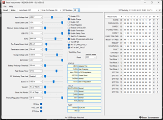

  • Hi Juan,
    Updates. The charging current was increased when I attempted from almost empry level. I used the adapter rating 3A at 5V.
    Charging at 1.2A or around 900mA:
    • VIN = 4.34V
    • VBAT = 4.15V
    • VSYS = 4.15V

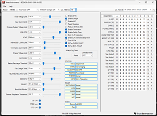

    The register values are attached. The difference between aorund 700mA and around 1A is just Input DPM mode state.
    Around 1A:
    Around 700mA:
    Please let us know if this results are expected.

    1A ICHG Case:
    Based on the configured "Input Voltage Limit" and your VIN voltage of 4.34V, as well as the "Input DPM" status showing as "In DPM Regulation", I believe this is VINDPM limiting the amount of current pulled from your source. Although your source is 5V and 3A, it is possible the resistive path between your source and the charger is causing a significant drop in voltage at the VIN pin. The voltage dropping down to the Input Voltage Limit will prevent additional current from being pulled and this will cause a reduction in your charge current. If you reduce the resistance between your source and the VIN pin, or if you reduce your Input Voltage Limit, do you see an increase in charge current and does increasing Input Voltage Limit reduce charge current?
    (Please note that Input Voltage Limit shouldn't be within 120mV of the battery voltage since this can result in the device entering sleep mode if it is being regulated by VINDPM)
    700mA ICHG Case:
    This case does not seem to indicate that VINDPM or IINDPM is limiting the amount of current to be charged, however with the battery voltage of 4.15V and a battery regulation voltage of 4.2V, it is possible that the device is entering the CV stage of charge, which will naturally reduce charge current. If you keep increasing battery voltage slightly, does the charge current continue reducing? If you raise the "Charge Voltage Limit" does your charge current increase if you keep battery voltage at 4.15V?
