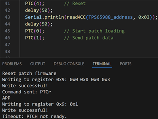

Unfortunately I have had several issues:
  • Attempts at writing to registers did not cause the register data to change when reading back

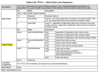

  • I have tried to understand the use of 4CC, but didn't get any significant results in this regard

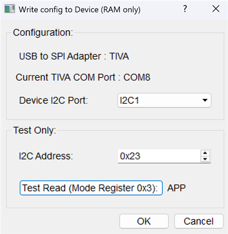

  • When using the customization tool, I don't seem to be able to export my configuration to the device RAM, see pictures below for use with TIVA. Note, this was attempted with the Arduino removed from the system in order to avoid any possible interference.
This is in spite of when I use the adapter settings, everything seems fine. Below is a picture of the Adapter Settings and a picture of what I read out with my current code running on the Arduino Uno.
I hope you can help me resolve this issue.
