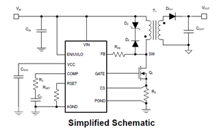

I am reviewing a boost flyback design using LM5156.
Vin: 9~16V(TYP. 12V)
Iout: Max. 0.6A
Vout: 24V
Is it possible to configure a circuit that receives the primary voltage of the transformer as feedback using PSR method and produces a single output?
For example, I want to make a circuit like LM5185.
