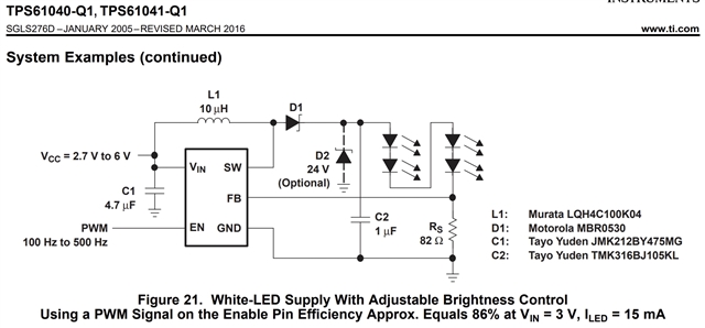

Hello
i need to build 2 white leds circuits with PWM control, one with 6 leds and the second with 8 leds, with max current of 20mA.
i found TPS61040 ic which has a sample circuit for 4 white leds (attached)...
my question is can this ic support 6 or 8 leds and if yes what do i need to change ?
thanks in advance
 Screen-2025-01-13_08-24-53.pdf
