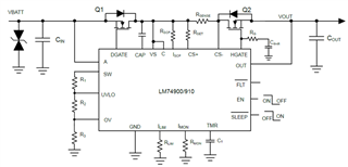

LM74910-Q1: How to let MCU control EN if MCU use the output power after two mosfet?
Part Number: LM74910-Q1
Hi expert,
My customer want to achieve ASIL-B level for overcurrent and overvoltage protection using MCU ADC channel. However they also want that MCU can be protected by LM74910, so MCU use the power from VOUT.
They use two VBATT/cable and the same VOUT for redundance to realize system ASIL-D.
If EN is pull-up to pin C(6-36V) by default, how to control EN pin by MCU if MCU need to turn off one of the LM74910 for some protection?
