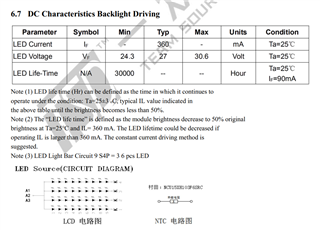

I’ve designed a custom board featuring the LP8866 and SN65DSI84. I’m encountering an issue with the LP8866: Vout gradually drops to Vin (12V). I tested the circuit using an oscilloscope and noticed that the pulse period on the GD pin becomes progressively longer.
I’ve also checked the I2C communication, and there are no errors reported.
I've attached schematic file
