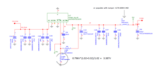

We are using the LMZ23605 with 12V in and set up for 3.3V out. Our application is for 3A max load on output.
We had a failure of this part in our application where the output (pin 7) appears to be shorted. There is no output voltage
and the output measures 3.5 ohms with an ohmmeter. Since the part has output short circuit and thermal protection and we are not loading the output
anywhere near the 5A maximum we are wondering how the part may have failed.
We are not using the part in a high temperature environment (35C max)
We are connecting the PGND/EP to AGND properly as specified in the datasheet.
Any information on how this may have occurred would be great. Are there any known issues with the part?
Any history of failure analysis would be helpful.
Thank you

  • Hi Joshua,
    Thanks for the response.
    This is a classified project so I can't share much. The schematic is shown below:
    We removed the part from the board and found that the Exposed PAD/PGND was shorted to AGND (~0.8 ohms).
    I think these should be isolated and connected only on the circuit board.
    Also we are leaving the enable line open circuit (floating) as mentioned on page 18 of the datasheet as there is an internal pull-up to enable the regulator.
    The absolute maximum rating in the datasheet is 5.5V on the enable pin. We are measuring 6.4V with the enable pin floating. I this an issue?
    Frank
  • Hi Frank,
    Enable should not be higher than 5.5 V as this goes above the abs max ratings as stated within the datasheet. In the case that Enable is left open, the internal UVLO is stated to occur at 4.3 V (please see section 8.2.2.2 of the datasheet).
    Were the exposed pad and AGND welded to each other or were they electrically shorted i.e. via a continuity test.
    Would it be possible to do an ABA swap with this IC and a fresh EVM? The purpose of this test is to determine if it is an IC issue or a schematic issue that may be causing the issue.

  • Hi Joshua,
    The exposed pad and AGND were measured with an ohmmeter and read ~ 0.8ohms (so electrically shorted).
    We ordered some actual parts and an EVM for the LMZ23605 so what you stated is a good next step (ABA swap).

  • Hi Joshua,
    We replaced the LMZ23605 on the original board that had the failure, and the board is working fine now.
    So we are still wondering what happened to the part.
    I also got the eval board for the chip and got that running. I did notice that on the Eval board with the enable pin floating
    the pin floats up to 6.4V just like our boards do. The max on this pin is 5.5V per the datasheet. Is this only for an externally driven enable?
    Frank

  • Hi Frank,
    Understood. Thank you for confirming.
    Yes EN can be left floating for this device as it has an internal pull-up. Just a couple more questions:
    What is the input/output profile that this device was running in when the device failed (VIN, VOUT, IOUT, FSW)?
    Was L2 shorted or connected?
    Thank you,
    Joshua Austria
  • Hi Joshua,
    VIN= 12VDC, VOUT= 3.3VDC, IOUT = 3A max
    The sync is not used and this pin is grounded per the datasheet, so the free running FSW should be 812kHz
    Frank

  • Sorry forgot- L2 is not shorted. I'm not sure about sending the layout since it is classified. I'll find out.
    Frank
  • Hi Frank,
    Sounds good.
    Is this inductor a part of the input filter for a device downstream of the module? Can this be shared?
    The layout would be the next step in reviewing your issue. If there is a concern about the publicity of this forum, you can always send me a direct message on E2E.
