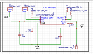

I am looking for some help with some power supply fluctuations I am having with a XTPS629210QDRLRQ1. I have designed the board with the 2.2uH inductor and 22uF capacitor as close as possible to the IC with the same schematic as the TPS629210EVM evaluation board.
The load is 12mA, 35mA or spikes at 250mA. There seems to be a power fluctuation at 35mA constant draw at a 1.5uS frequency where it drops down to 1.8V and recovers back to 3.3V and if the load is reduced to 12mA it seems to fluctuate with similar magnitudes every 30uS. I have notice the series resistance of the inductor I am using is 10x higher roughly than the evaluation board but i am not sure if this is the root cause. Can someone give me some help as to what is going on?
