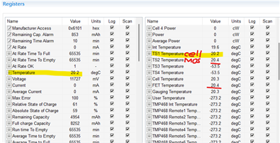

The BQ40z50 V5.04 firmware supports temperature sensing with the TMP468 IC, which offers up to 8 channels.
In addition, I have connected TS1 and TS2 using NTCs, allowing the system to support up to 10 temperature sensors.

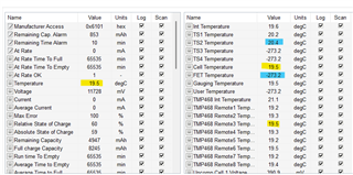

Before enabling the "TMP468_en" option in the DA Configuration, the temperatures for TS1 (cell) and TS2 (MOSFET) are displayed correctly in the SBS Temperature as well as in the TS1 Temp, TS2 Temp, and FET Temp readings
However, after enabling the TMP468_EN bit in the DA Configuration (TS1 and TS2 are also enabled), the SBS temperature only displays the maximum temperature from the TMP468 channels (T1 to T8).
The gauge automatically ignores the values from TS1 and TS2, and the FET temperature reading becomes inaccurate as well.
Could you please confirm if this is the correct firmware behavior when enabling TMP468_EN?
Specifically, does enabling TMP468 mean that TS1 to TS4 and TMP468 cannot function simultaneously?

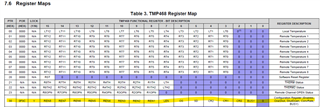

    1. How do I confirm the current setting for "configuration register 30h" for TMP468?

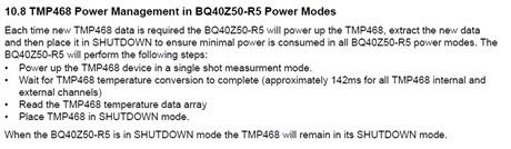

    2. We've tested the shutdown mode power consumption, and it still seems to draw around 100µA.
        According to the TRM, the TMP468 should enter shutdown mode, but based on our power consumption test, it appears that it did not.

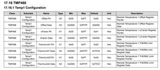

    3. The manufacturer access cmd 0x008A TMP load Config is used to reload the TMP468 configuration
         What's the defualt setting for this configuration? When would I need to reload it?

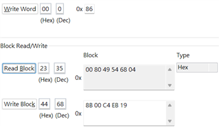

    4.  The manufacturer access cmd 0x008B TMP write register, how can I send this cmd via Advance comm SMB
         For example, if I want to change the TMP configuration (pointer register 0x30) from 0xFF18 to 0xFF38, could you provide the command sequence?
    I believe this should be available by using the TMPRead commands:
        How can I confirm whether the TMP468 is actually in shutdown mode?
    The SD bit seen in configuration register 30 should display whether the device is in shutdown:
    I believe the default values for these configuration settings can be found in the TRM. When the golden image is programmed to a new device, the TMP468 will still need to be configured, which this command should do it all without needing to reprogram individually.

    If this were to be done in Advance Comm, I believe you would need to use the write block with 0x44, and in the block you would need to put 8B 00 for the command, then fill out the rest of the required information with the pointer and data:
    Yes, I understand the SD bit in configuration register 30. However, according to the TRM, it should enter shutdown mode via the bq40z50, but the test results don't seem to reflect that. Could you also double-check the shutdown mode consumption with the TMP468 with the FW team?

    I've tried unlocking the TMP468 using the commands 8B 00 C4 EB 19 and 8B 00 C4 19 EB, but neither worked. The lock register still returns 8000. Could you show me the correct way to unlock it?
    Sorry for the confusion, while the gauge is in shutdown with the TMP attached the consumption current of the gauge is 100uA? If so, I will reach out to our team to confirm this.
    I believe you need to write the necessary information using write block to 0x44 and 8B 00 C4 EB 19, then to see if it was written you need to use one of the TMPRead commands, where 81 00 is sent using 0x44 write block, then reading back 0x44 Read Block.
    Yes, that's exactly what I did, but it's not working.
    Is Auto-Refresh in bqStudio on at this time? If so, there could possibly be conflicts with the communication since this is constantly sending commands to the device.
    Yeah, the auto-refresh was turned off while I was sending the commands.
    Please also help confirm this:
    We plan to use the PBI pin as the EN signal for the LDO, so when the gauge enters shutdown mode, the LDO will turn OFF, completely powering down the TMP468.
    Are there any risks associated with this approach?
