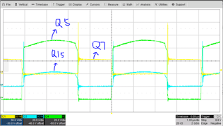

I was asked to ask my question here. I'm having some problems implementing the active clamp forward design with the PoE chip TPS2373 and the UCC2897A. I believe that the UCC is in a hiccup mode. Can you please help me solve this issue.

    Sorry for the confusion. I used the TPS2373 as a reference design. The output voltage of this system should be 5V. Its now 1,3V. I noticed earlier with a thermal camera that D5 was getting very hot. I also could here an audible switching sound. I couldn't find the issue so i contacted the TPS2372 team.
    I measured the gate voltages of the FET's and it looks to be normal.
    Then I measured VCin and VCout.
    Green is VCIN; Blue is VCOUT; Yellow is VDD.
    Could you please help me figure out how to fix this issue.

  • Dear Hong,
    See the main post of this thread. the schematic is added
