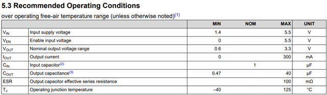

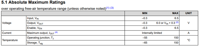

I understand the devices must follow Absolute Maximum Rating in order not to have risks to damage device, and must follow Recommended Operating Conditions in order for device works.
But I see some unknown description in TI.com Web page.
Firstly, datasheet shows -65 to 150 as ABS MAX of junction temperature. -40 to 125 as recommended junction temperature.
These definiton is both "junction" temp, which should be calcurated with thermal resistance and internal power loss.
However TI.com product folder( https://www.ti.com/product/TLV773 ) shows -40 to 85 below.
Also, at the end of datasheet shows below.
How do I understand the Op temp other than ABS MAX and Recommended rating?
