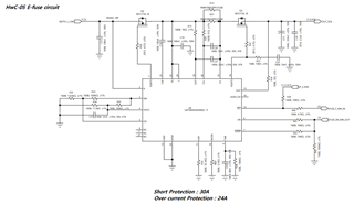

I made a circuit using LM74900.
It does not have reverse voltage protection.
I have attached a photo, so please review it.
I don't know what is wrong.

Hi Um,
Welcome to E2E!
Please keep pin25 (EPAD) floating. Rest, the schematic is fine.
