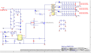

One of the reference designs for UCC28730 shows HV pin pull resistance of 900k for 60V-1000V Vin. (Refer image)
According to datasheet, the start-up current required is 250uA typ.
The design referred here provides
60V/900k = 66uA.
Can you explain the selection of this HV start-up resistor?

    It looks like they did not plan on a 60 V startup. You are correct that these resistor should have been smaller to support the 60 V startup requirement.
    Another option to drop the HV voltage would have been to use an NPN transistor as drawn below.
